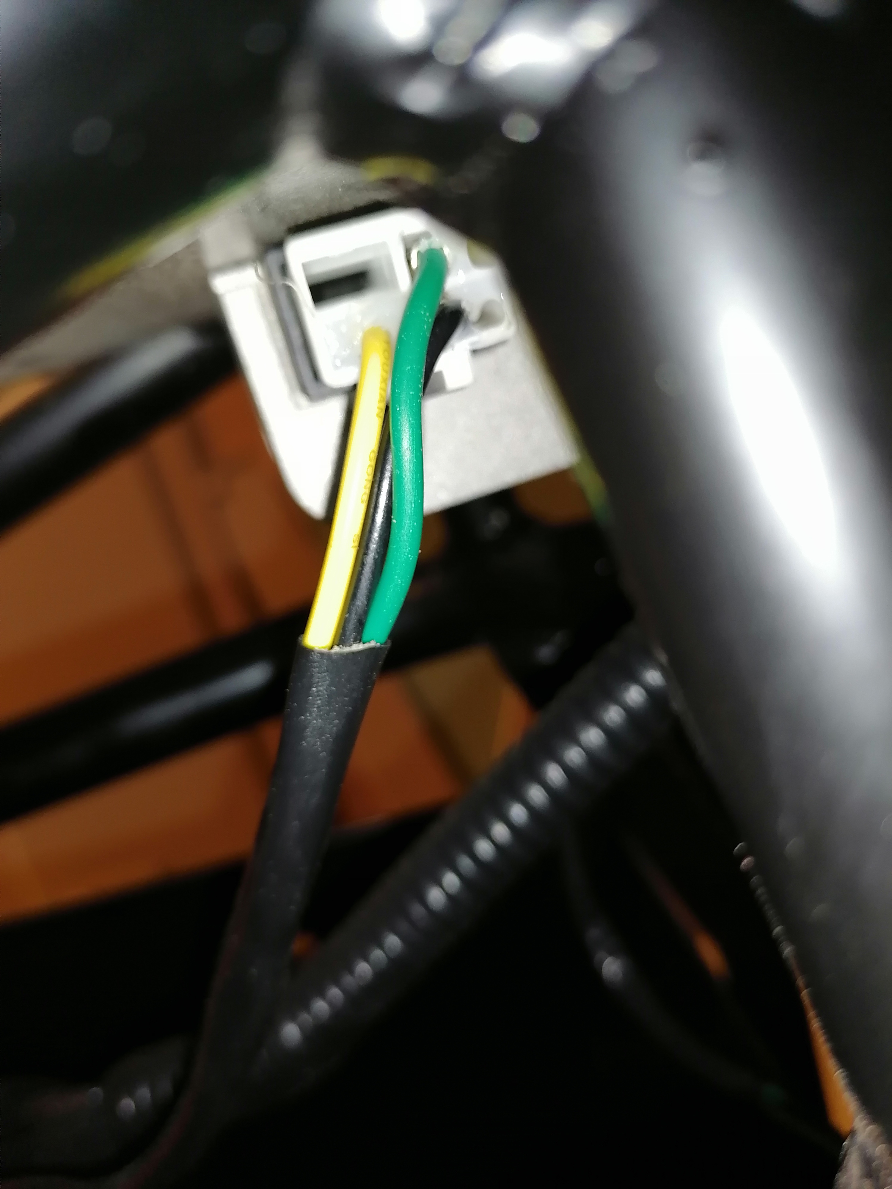

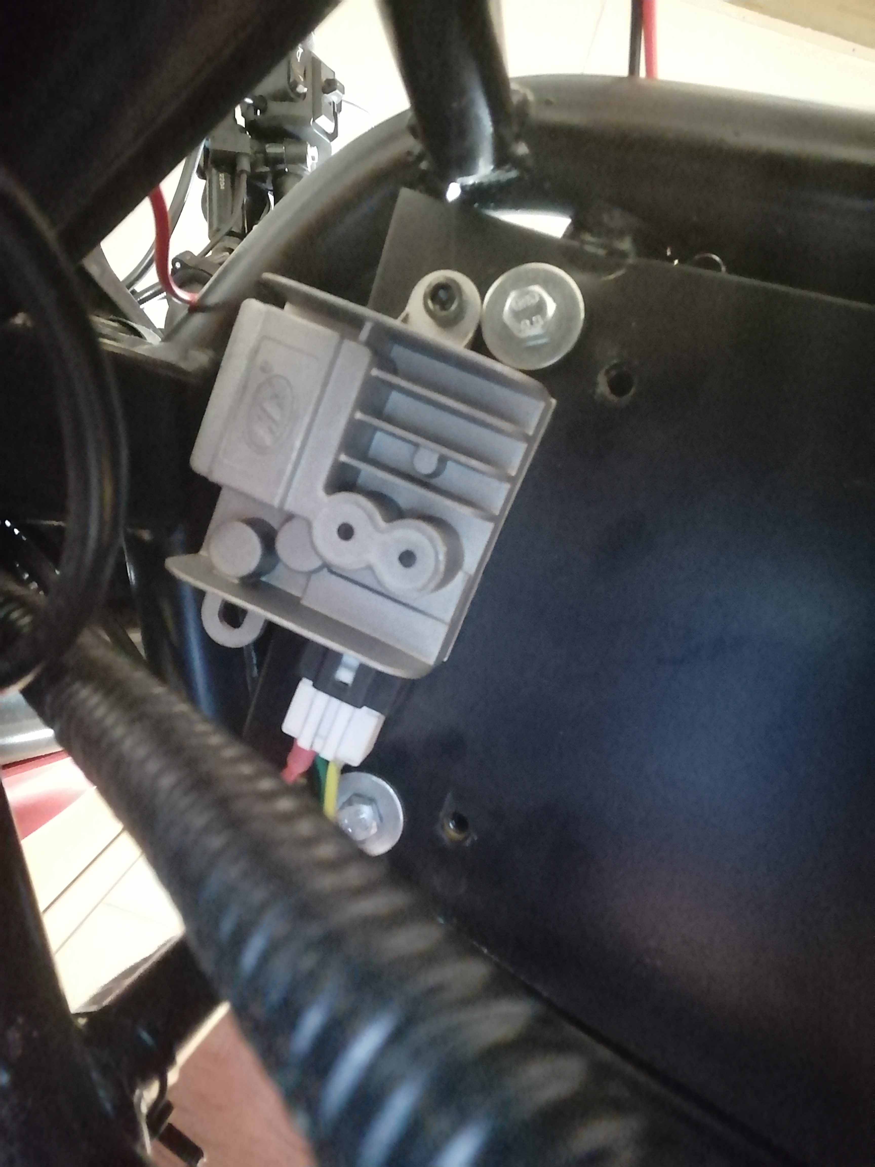

Re: Liegen geblieben - Maschine tot
If you have this DC changer, you can take 12V from black wire and ground from green wire (yellow is batt+ from controller, but measure it by yourself). I added a fuse box next to the breaker and it powers 2 dashcams with display and USB charging socket without problem.
