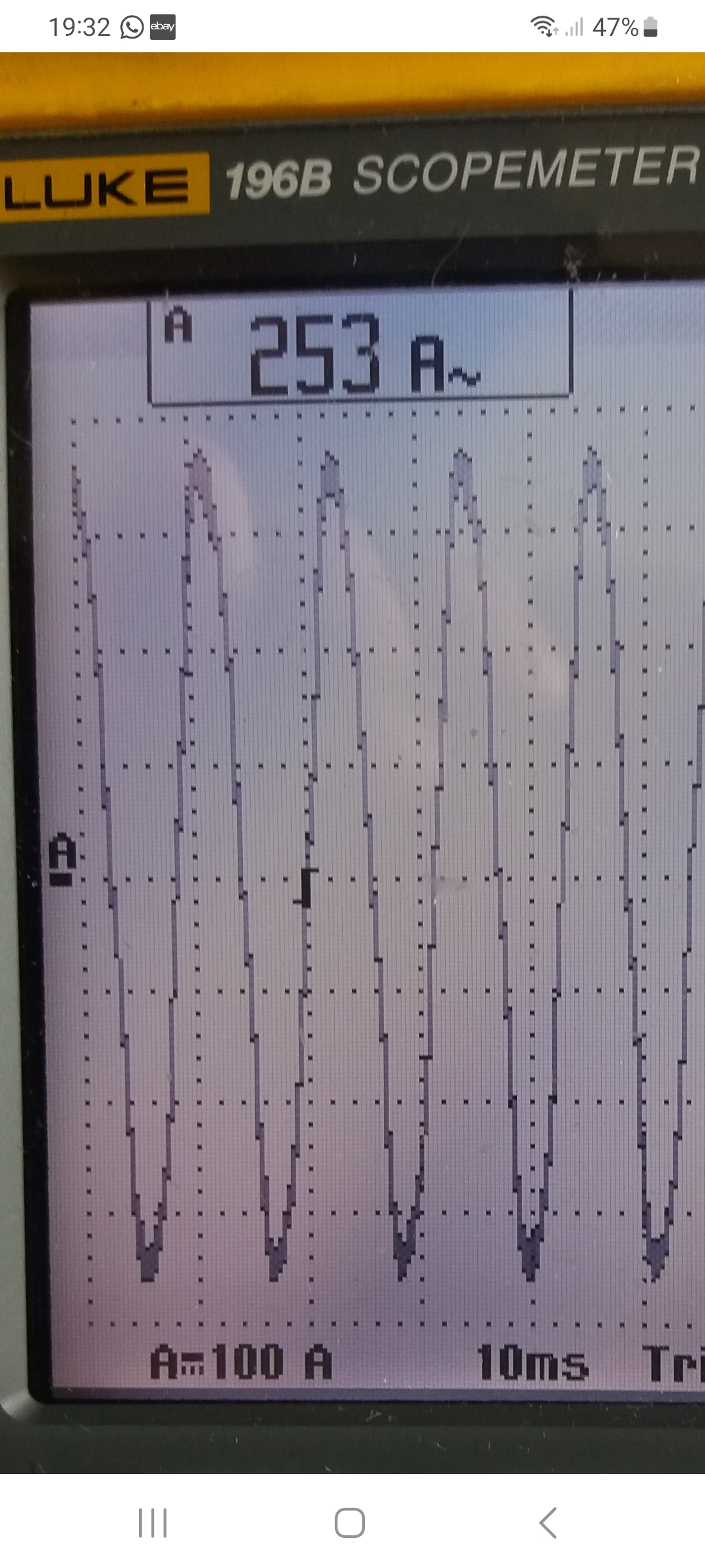

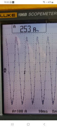

The current waveform looks like AC
I have measured my SVMC72150 with a rogowski current transducer and an oscilloscope

Beitrag von dominik »
This measured 250A are the same as the advertised 350Apeak from Sabvoton.
The most Controller manufacturers advertise the peak phase current. [Sevcon not)
The peak is the highest point of the sinewave. It is calculated Ipeak= Ixsqrt(2)
250Ax1,41=353Apeak
Motor power is calculated
P=U x I x sqrt(3)
U is Ubattery/sqrt(2)
80V/1,41=56V
So max RMS Voltage the controller can make is 56V without losses.
When the controller makes 80A phase current at full speed you get 56Vx80Ax1,73=7700W
Battery current is then somewhere around 100 to 110A.
