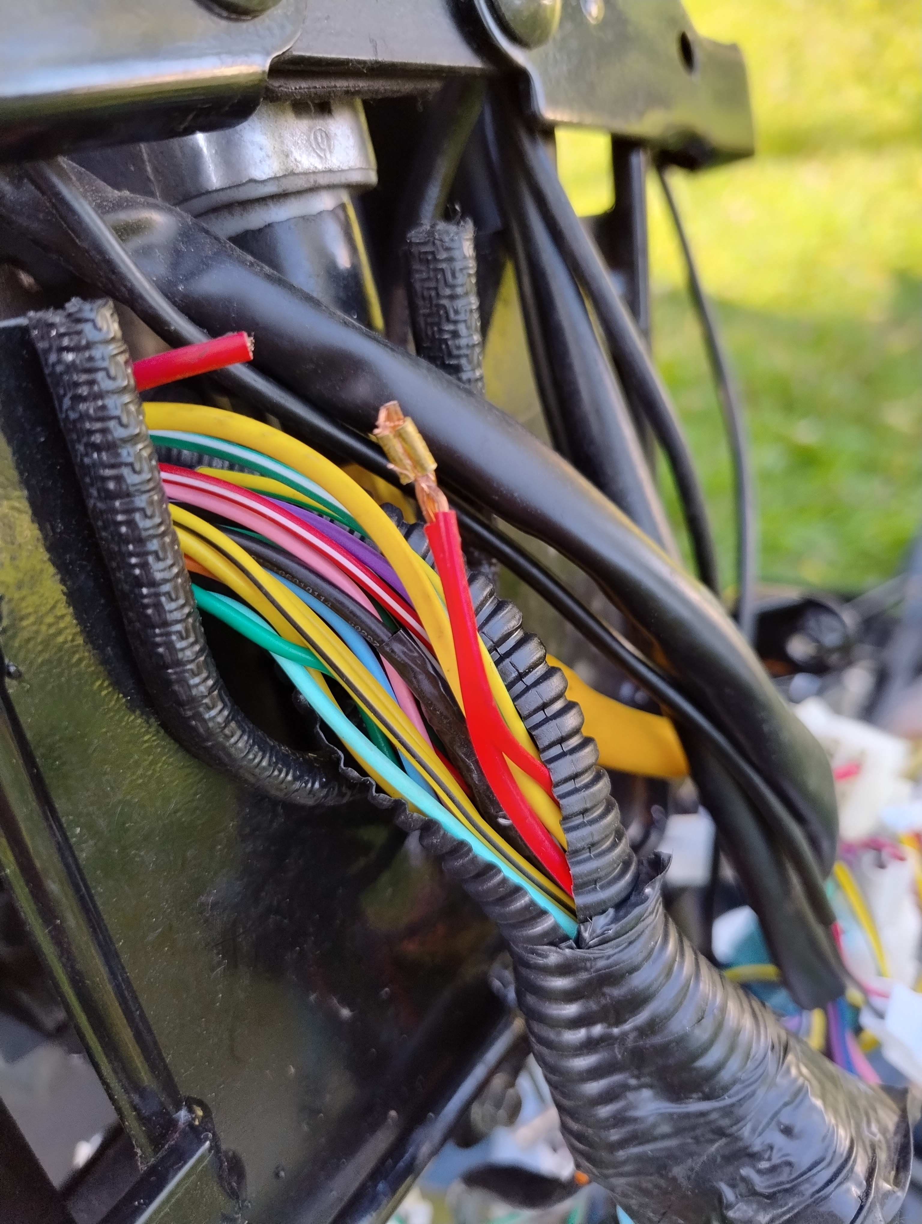

Hello again. It has been a long time since my last post because the weather has only just got better here in the UK, which meant I wasn't able to do any work on the bike. I finally took the battery out and tested the resistance on the eodin 3.0 controller. Seemed fine between phase and ground (about 5 kOhms). That's ok right?
I was wondering what the resistance to the hub should be between two phase cables (when detached). It seems there is hardly any resistance at all. Is that correct?
I'm still have no idea what is wrong with the bike, the display does not work when I turn the key (no power, nothing) but does light up when I use the fob, but the motor makes a slight grinding noise. Any help diagnosing the problem is very appreciated.

Hi, a quick update on this. I found a broken cable from the ignition (red cable) in the bunch of cables leading back to the DC converter and controller. It seems the flexing of the cable due to steering caused a break. I reconnected it and the dashboard now works. All I need to do now is put the bike back together! Fingers crossed that is all.

Yes, the Ohm-Resistance of phase windings should close to 0, as anything more is an electric heater, instead of an efficient electric motor. That is why modern controllers are extremely careful when applying phase current at standstill or low rpm. Only at higher RPM the inductive resistance rises, and back-EMF also starts doing its thing, thus limiting maximum rpm automatically.
Great that you seem to have found a solution to your problem!
