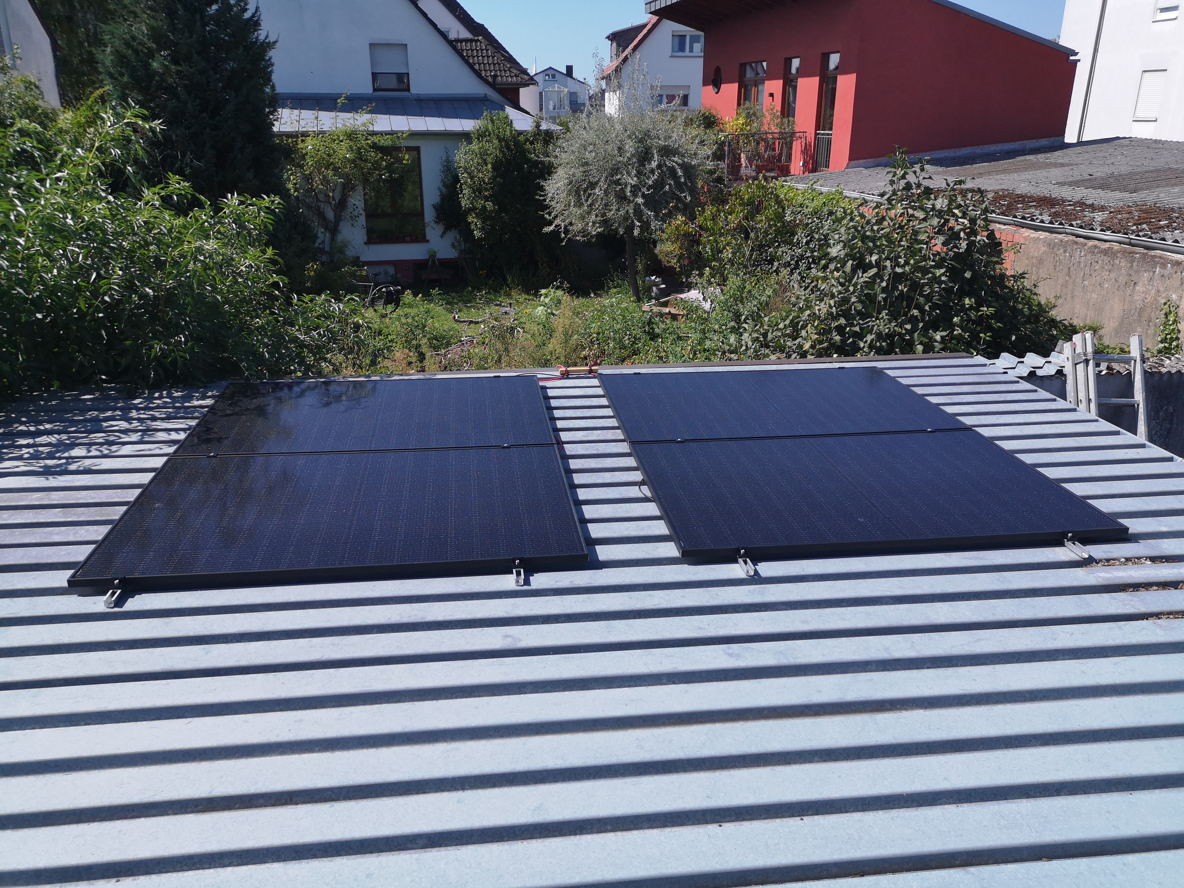

Lade ich hingegen mit meinen Solarpanels auf der Garage (2x810W + 2 sekundär parallel geschaltete MPPT-Boost-Charger),

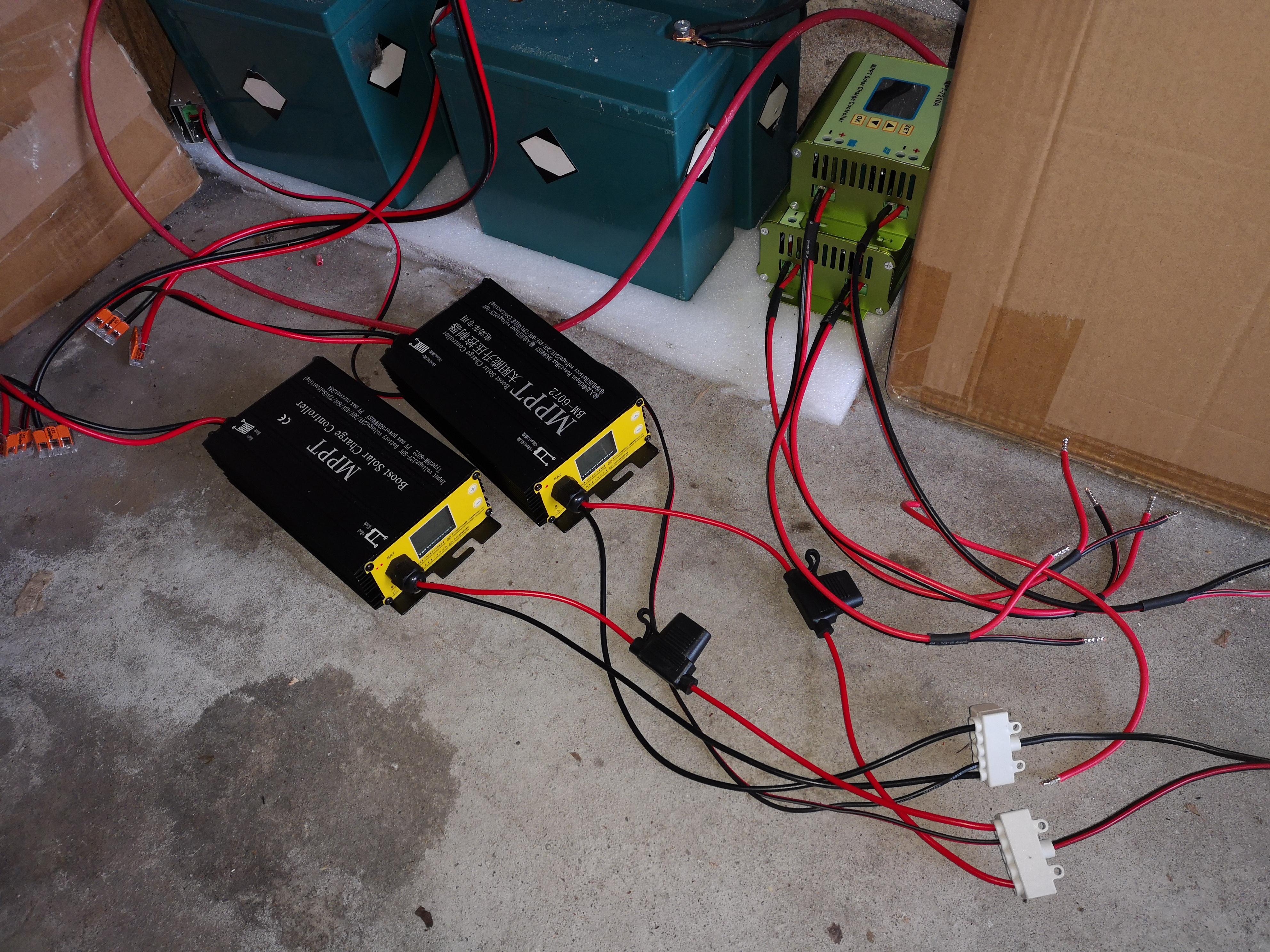

I use these BM-6072 and yes, the outputs of these boosters are connected in parallel, means red wire (+) connected to red wire (+) and black wire (-) to black wire (-).
The inputs of these MPPT-boost charge controllers are each connected to an own PV circuit (2 panels each, in parallel at my side but it should work in series too).
You can't connect both mppt controllers to the same PV circuit... they would drive each other grazy (even MPPT / PWM controllers interfere with each others).
Recently I discovered that you can manually adjust the max. output voltage, but it's very fiddly with the tiny buttons, the tiny LCD and the user unfriendly menu.
Finally I managed to set them to 84.5V each.
I've checked these MPT-7210A controllers as well. But the over all power output is way poorer than with the above linked BM-6072.
Both MPPT boost chargers (MPT-7210A and BM-6072) will work without a battery at the output... and they start up when the sun is rising with the previously stored settings.
I even bought this controller too (60A version), but it's still unused in its original packaging.
If you are interested, I'm sure we will find a deal :P .
It would require that I connect all 4 PV panels in series to connect them with the controller. Because it's not a boost type controller, so the input voltage always (even in a cloudy situation) needs to be higher than the output voltage.
But I don't know if this type of controller will work without any battery at the output (it might need power, even during the night, when you would like to retrieve data via RS485).
My first attempt to charge the E-Odin battery (or the 72V/20Ah batteries of my Futura Classico LI) was with these DC-DC boosters, but that was very problematic when a cloud moved between sun and panels -> finally it fried me the HY3912 MOSFETs at two of these circuits. These modules can't cope with an unsteady input power.
So I stick to the 2x BM-6072 solution, because it works and it is performant. But it requires 2 disjunctive input circuits.

What I do not understand is why do you think that MPT-7210A has lower power output than your BM-6072 - sellers description says that both of them is max 600 W out, 12-50 V (BM) / 12-60 V (MPT) in, so basically same. Am I missing anything ?
I have both.
The specs are similar, but the performance isn't.
I simply checked it out during mediocre weather.
One PV circuit as input to the BM... the other to the MPT..., outputs in parallel with an Amp-meter at each.
As it was cloudy the BM-6072 delivered 3.5A charging current while the MPT-7210A only delivered a measly 1A.
As the weather got worse and it started to rain, the BM delivered about 1A but the MPT stopped charging at all.
The difference between both might be lower during bright sunshine, but I haven't tested it so far because weather wasn't either great or I was busy with other stuff.
I guess the two devices have different MPPT algorithms or strategies implemented.
It shouldn't be a problem that the panels are able to to provide more power (810W), the BM-6072 won't deliver more than it's 600W... the higher power simply won't be used.
Both boost charger models are protected, which means that they lower the output current when their MOSFETs get hot.
