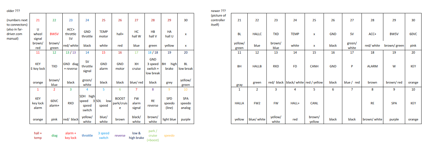

Hmm, I should start with question what controller TwisterMax actually has and add "classic" diagram (that did not fit to my controller so I considered it to be wrong). Thanks Jeff, I corrected my previous post.
Screenshot 2023-12-10 at 05-39-05 Sb95cd1a256e5462d9a89295f0e0ec68eq.jpg (WEBP obrázek 1060 × 735 bodů).png

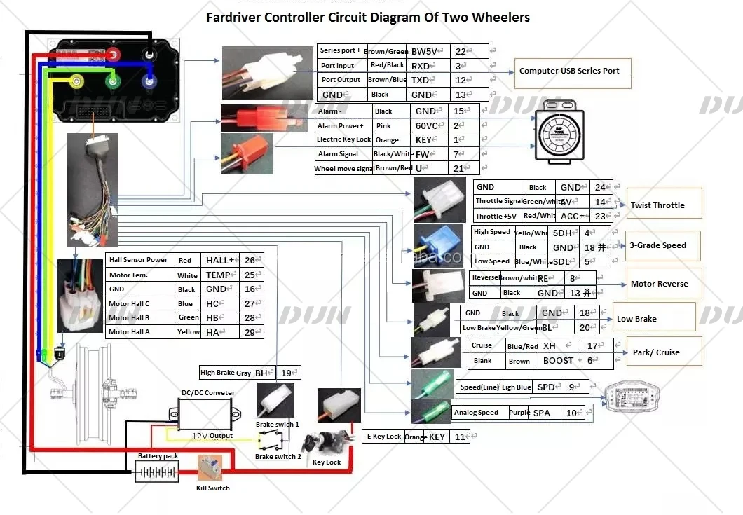

As I mentioned, I was not able to make work borrowed 72330 as a temporary replacement of my broken 72400, now I do not remember whether bike even turned on or not but I am sure that bluetooth adapter was not powered, that is when I started to measure "classic" pinout and did not find 5V so I made a little comparison because info from far-driver was that "classic" diagram:

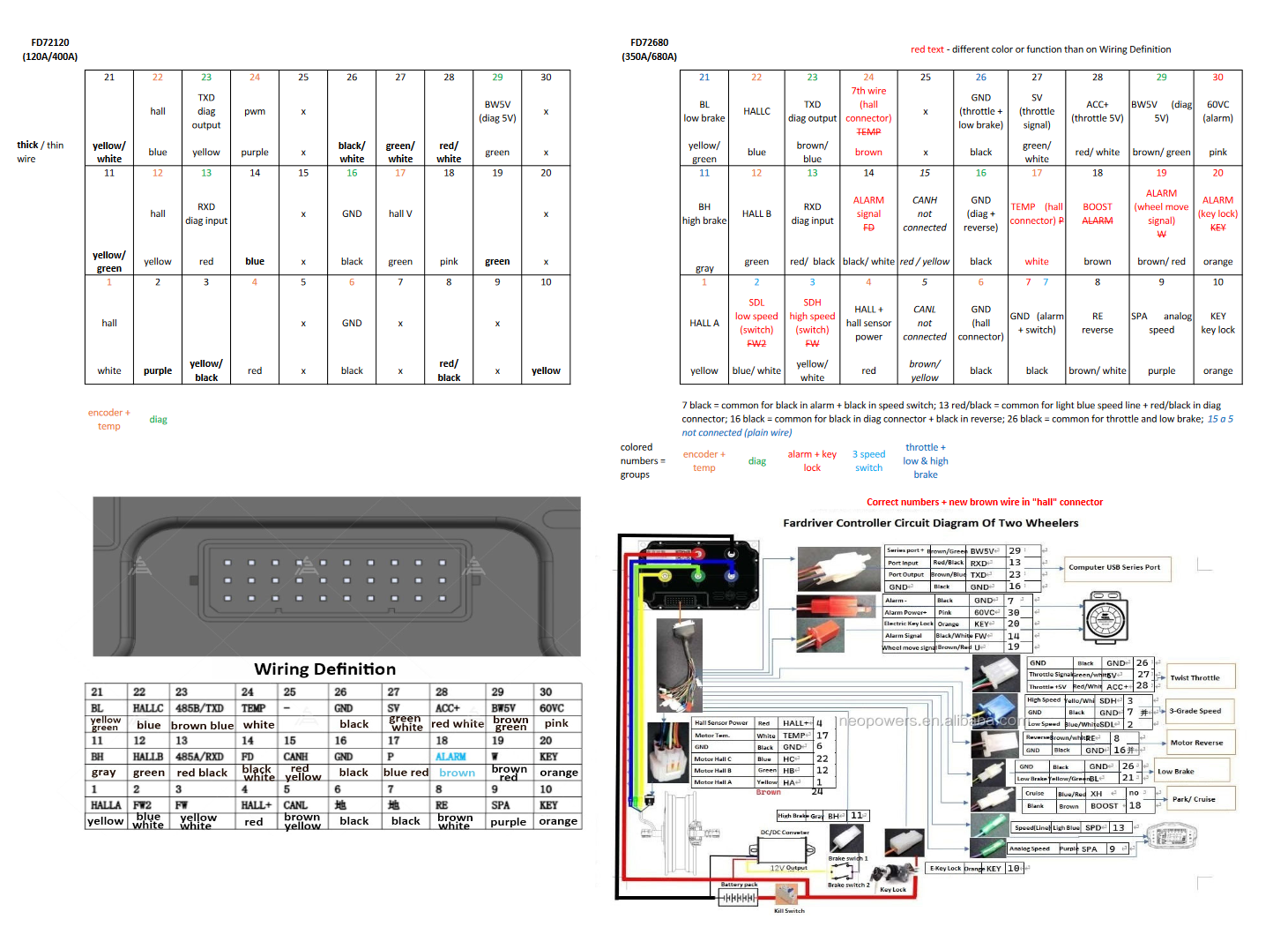

So conclusion is that - without messing with wiring harness - 72330 can be replaced with 72530 and "72400" in Odins with AMR motor with 72680.
That would mean that anybody with 72330/530 can not use 72680 (without changing wiring harness).
Well, I am getting tired of all that chinese mess. No racism, just wonder why they can not keep one pinout or at least provide clear info that from this model pinout changed. As trash tires, rear shock, brake discs, phone app etc. is not enough...

Ich habe nun mal meine Steckerbelegung angefügt. Vielleicht kann da jemand etwas damit anfangen. oben links ist Pin 1.

Nun habe ich mal meine Version (schwarz) mit der von Jeff-Jordan (rot) verglichen.
@jeff-jordan Ich habe PIN22 jetzt nochmal am Controller gemessen. Da sind definitiv keine 5V drauf.
