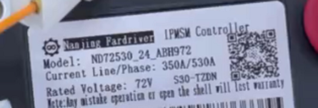

Am I likely to get a 'Chinese fake' Fardriver controller, or are the Fardriver controllers already Chinese copies of something else? :? Does this look 'real' -
I will reconnect the original controller and then test it with the lead, and try to download the variables in it so I can set the new one up exactly the same (to start with). Wish me well, I might be back for advice. Any tips to do it best would be welcome.
Beiträge: 19312
Re: E-Odin 2.0 und Fardriver ND72530
Fardriver IS a Chinese Company ;)
