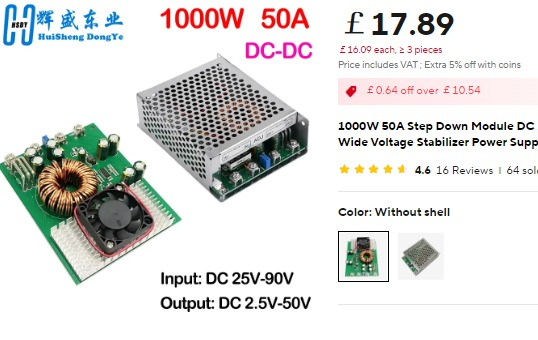

Perhaps it is the same on all such bikes.
But I can see how adding this feature would work on my bike.
I have a grid tied box that can convert solar panels (up to 55V) into mains power.
I probably would not want to connect it directly to the battery anyway.
By doing this, I can then power the house.
I get cheap power at night, and use a few kWh in the day.
How much life would I take out of the battery by cycling it through 4kWh every day? It would save me a few pounds a week, say £200 a year.
