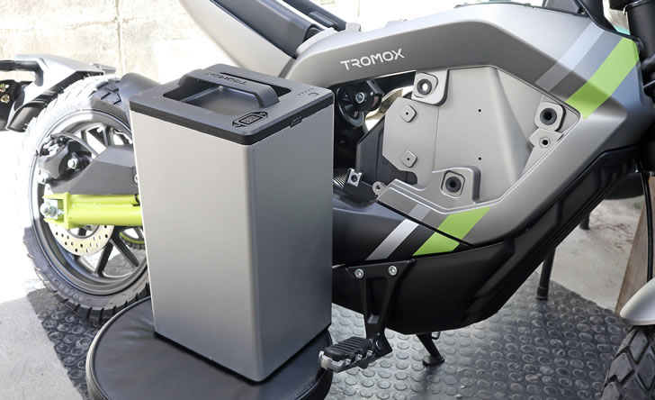

VCU is an on-board computer, with Bluetooth, GPS, GPRS. In addition, it is an RS485 bus master device. It is installed under the right side cowling.
For Tromox Mino B you can see empty space for VCU (with four mounting points):
