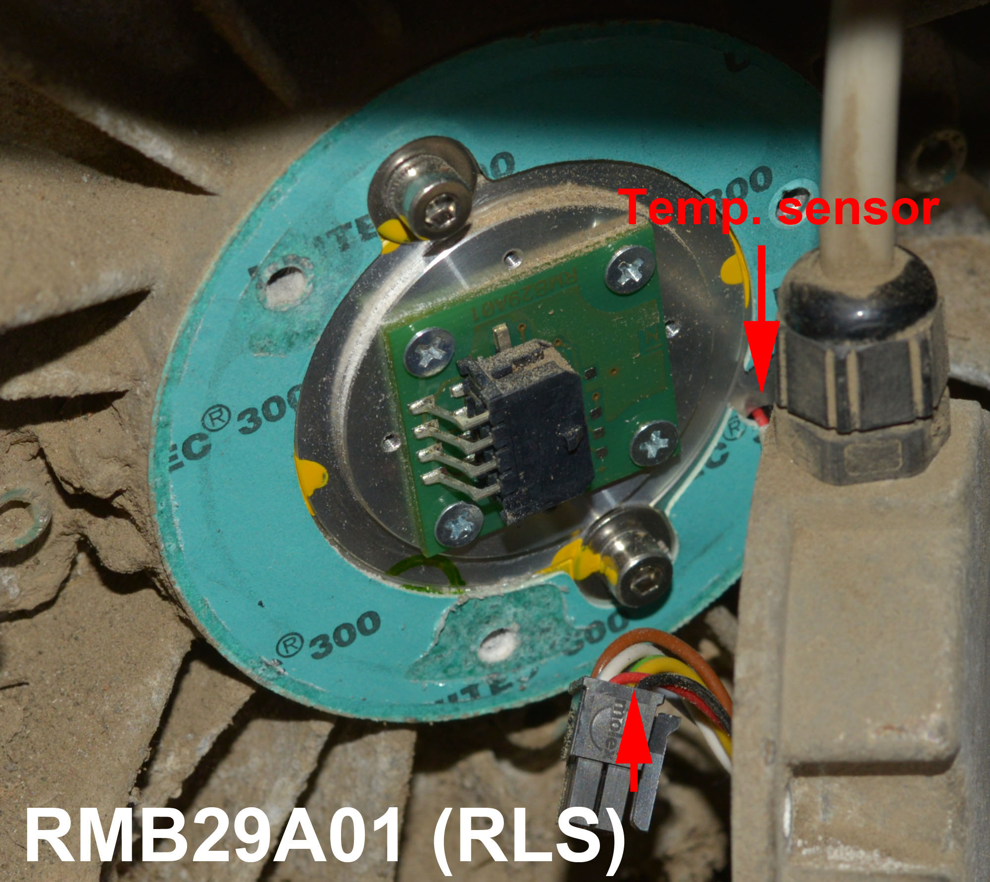

For a test, simply connect a 560Ω resistor between NTC connector of the SEVCON plug and GND. (which is scooters metall chassis). http://fs5.directupload.net/images/160518/him63ayo.jpg
The KTY130-84 sensor (cheap) is the red/black wire coming out of the motor underneath the encoder case , as to be seen @ the thread linked by Dirk above. App. 500Ω @ 15°C. Unfortunately you probably can´t replace it w/o disassembling the motor.
PS: Maybe its just a conn. prob., just check the wiring all the way up to the SEVCON plug .
