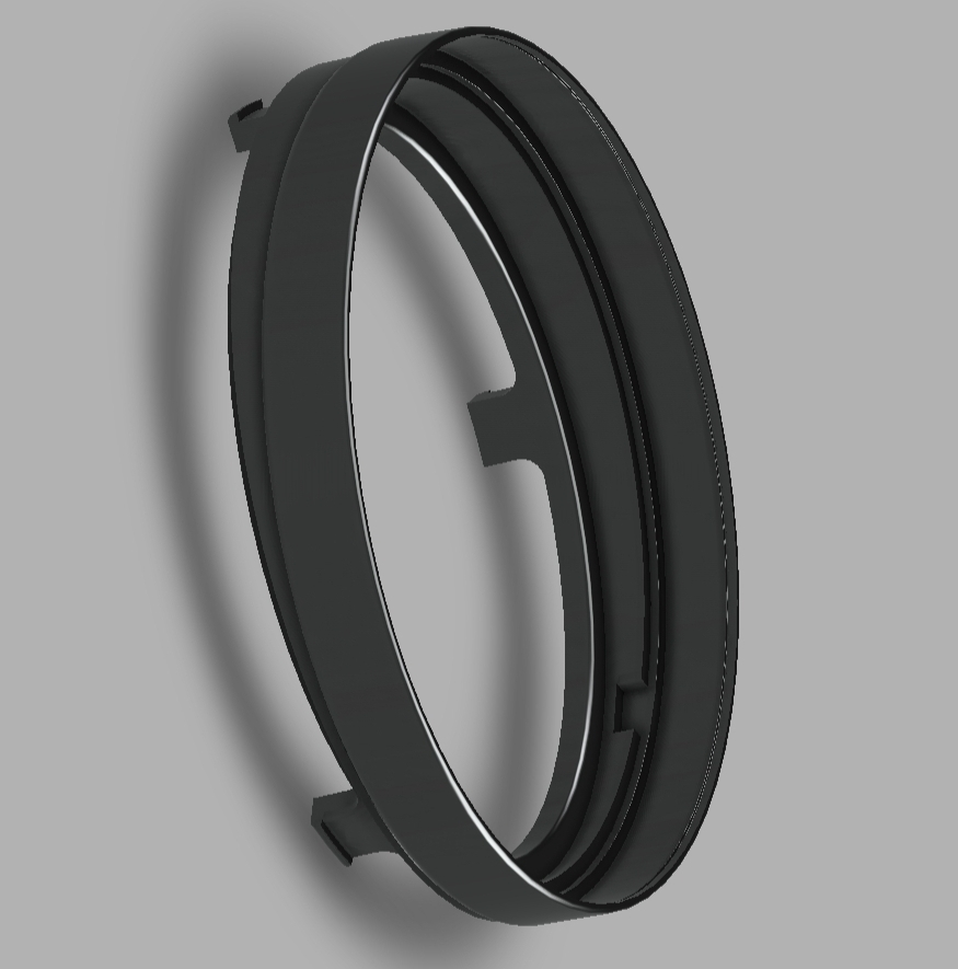

Danke. Ich bin kein CAD-Experte, daher ist Schritt 1 nicht sehr professionell ;)
Aber die Variante sieht doch zu sehr nach DIY aus und man sollte in keine Kontrolle kommen :-(
Richtig. Ich kann den Winkel im CAD-Modell problemlos ändern, daher muss ich ein paar Tests durchführen, um den richtigen Winkel für mich zu finden. In zukünftigen Versionen wird die bereits vorhandene Scheinwerfereinstellung verwendet. Allerdings muss ich meine CAD-Kenntnisse verbessern :geek:
Vielleicht den Halter und den Unu-Lampenhalter in der gleichen Farbe lackieren?
Ja, der ganze Roller muss neu lackiert werden, also wird das passieren.

Version 1 is up and running and it is a HUGE improvement. This is actually a PLA print instead of PETG because I was still making changes but it is working and there are a few more details I should improve for a version I would use longer-term. I'm debating printing a final version 1 with the last revisions or just start on version 2 with the headlight adjustment that works like the Unu headlight adjustment. I finished the wiring and I made new plugs so it can be removed easily for service. The LED headlight has a daytime running light "ring". When connected to the turn signals, this ring flashes orange which I thought was odd but decided to connect up and try (see video below). To get this to work I used two diodes from the left/right turn signals so they don't backfeed each other.
Here's what the version 1 mount looks like. There are actually three parts, there's a ring in the front that is a press-fit that holds the light in place and a ring at the back to make sure the whole assembly stays attached to the Unu.
