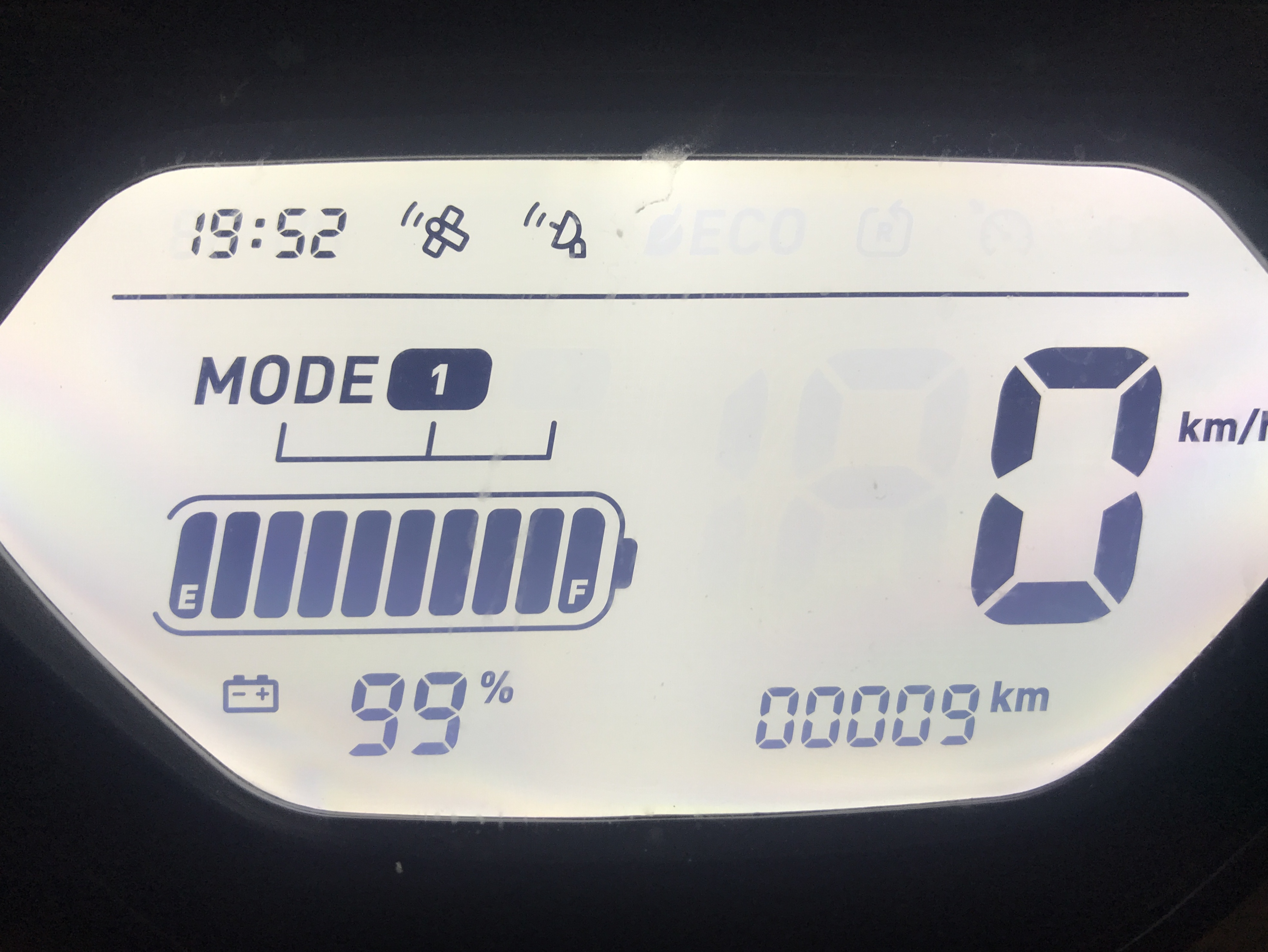

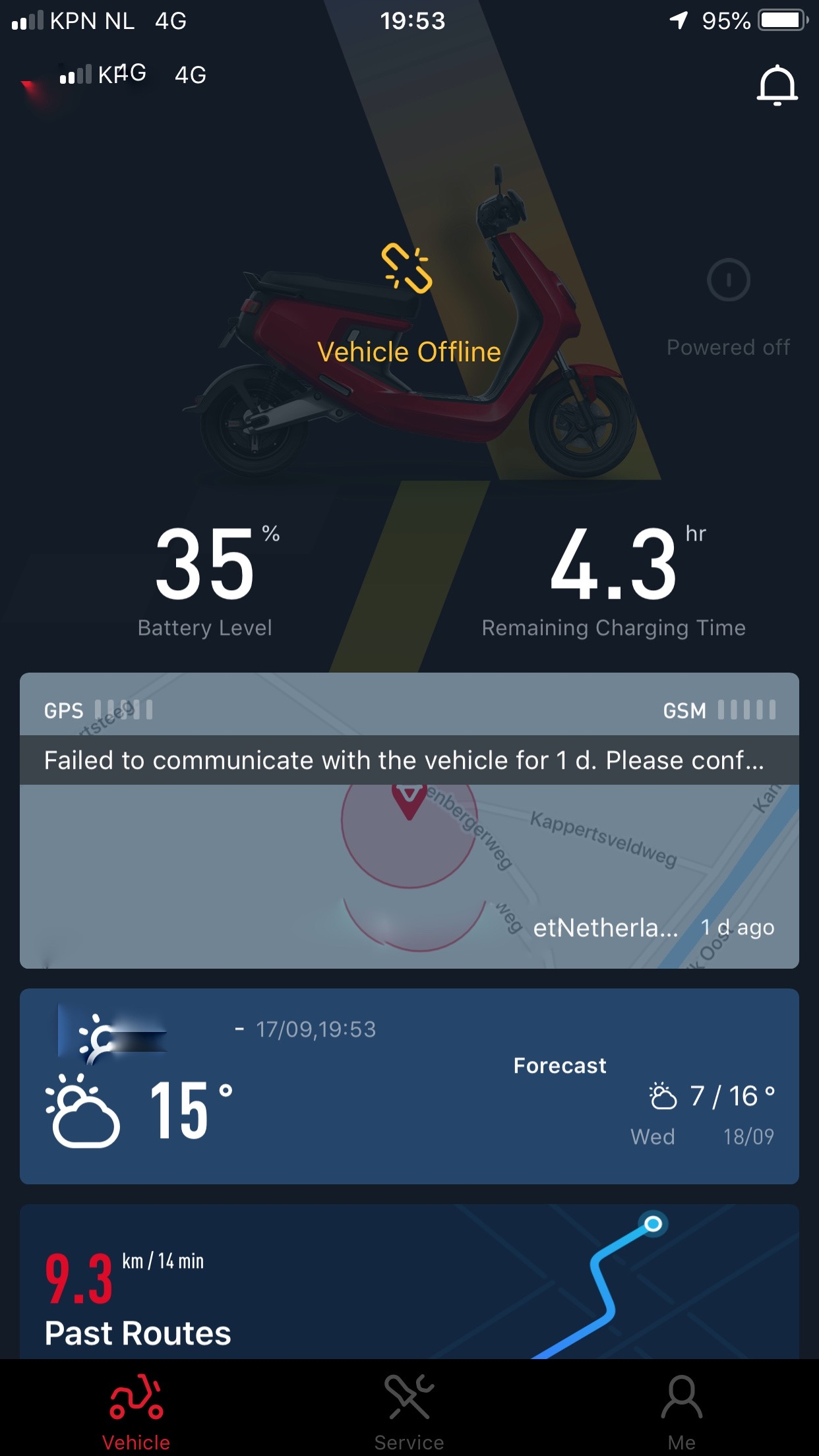

well the new ecu finally arrived in the app after more than a day...
but it now says the scooter has been offline for more than a day.. which.. it isnt..
while my scooter display clearly states it has gps and gms signal, see photo.
the scooter is also stationed at a spot where it always had good gsm connection before the ecu switch..
i even did the scooter outside for a few minutes which didn't solve the issue.. I also drove 9km yesterday which apparently wasn't recorded..
nice work niu!

Try to unbind your scooter with the owner's account in the App and then bind it again.
**If you have permission for one or more (sub) accounts in addition to the owner account, they will automatically be disconnected and they will have to request permission from the owner account again.
It's the same for me, no history in the App from the moment of installation until the completion of the registration on the server, for me this was more than 3 days.
