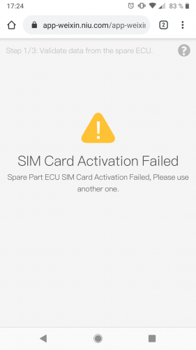

Hello,
Yes, we didn't do that, too. After we have seen the GSM-icon and no error 67, we have been too confident, that it should work sooner or later.
But I couldn't connect the ECU, maybe we should have used the H1.
Now Niu asked for it and they can go to sleep again until I've been to my dealer for the fouth time about this issue!

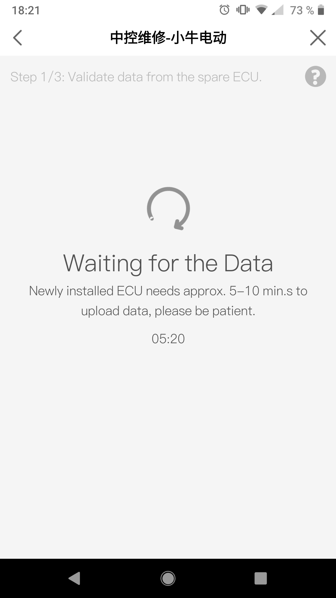

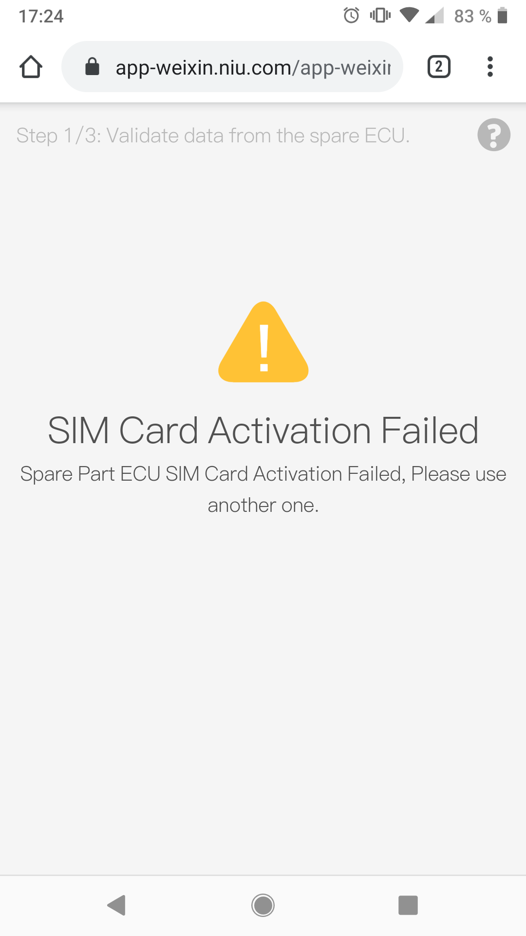

After I just tried again with the URL, I tried again with my mobile with the scan and the first time (after many attempts, maybe 12) I got the first time this message:
I retried and now I'm again at "Waiting for the Data" (for another 10 minutes).
My only clue is now, that the activation is usually confirmed by the server! At the attempt above it failed but usually it seems to be confirmed.
Or should I scan the new ECU from the Niu-app? Does it make sense to try this?
Best regards,
Norbert

It won't hurt if you try it with your cell phone. With mine, the importer did this with his mobile phone, while at that time he could have chosen his PC as well.
Make sure your scooter has a good LTE reception when you start the procedure.
Es wird nicht schaden, wenn Sie es mit Ihrem Handy versuchen. Bei mir tat der Importeur dies mit seinem Handy, während er damals auch seinen PC hätte wählen können.
Vergewissere dich, dass dein Roller einen guten LTE-Empfang hat, wenn du mit dem Prozedere beginnst.

Hello,
From Cellphone with a QR-Scanner or with PC with the link seems to be the same. You're endig up at the same URL finally.
What I mean is from the Niu-App. I'm just trying now. It looks similar but I don't see the URL but some Chinese. But still "Waiting for the Data".
Vom Handy mit QR-Scanner oder PC mit der URL scheint alles das gleiche zu sein. Man landet auf der selben URL.
Was ich meinte ist aus der Niu-App heraus. Sieht ähnlich aus, nur statt der URL sehe ich oben Chinesisch. Aber immer noch "Waiting for the Data".
The Chinese is just: "Central Control Repair - Maverick Electric"

i did everything from within the app.. scanning of qr too..
make sure the scooter has good gsm reception.. try outside!

At all the attempts the scooter was under free sky, always.
See my Avatar, thst's the sidewalk, beside the parking cars at the street.
At my dealers it was outside on his yard.

I had connection problems too, not like yours though, installation went well..
but I mailed hello@niu and they activated my sim...
Ich hatte auch Verbindungsprobleme, aber nicht so wie bei Ihnen. Die Installation verlief gut.
aber ich mailte hello@niu und sie aktivierten meine sim
:!: The Niu M+ Sport scooter drives great, but tech and app arent perfect (yet)... :!:

marcotibben hat geschrieben:
Mi 9. Okt 2019, 20:00
Haha, I wrote to Niu (questions@niu.com, Astrid) with reference to your case, Sim activated manually.
I told her, that I know, that they can do it, that they did this before and asked her to do this for my U3, too.
She asked back for the readings of the H1-tool, which we don't have.
