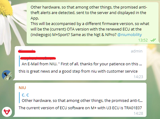

I think it is more interesting for us (Indiegogo M+Sport) to know if the N1Sport 2019 with the new ecu u3 (ecu firmware version E07) has your mentioned symptoms and hopefully not!

My source is a member of the Niu-team, who is responsible / the contact person for the European market, who is active in the Telegram group.
See his announcements in the Telegram group:
Meine Quelle ist ein Mitglied des Niu-Teams, der für den europäischen Markt verantwortlich ist / der Ansprechpartner, der in der Telegrammgruppe tätig ist.
Siehe seine Ankündigungen in der Telegrammgruppe:

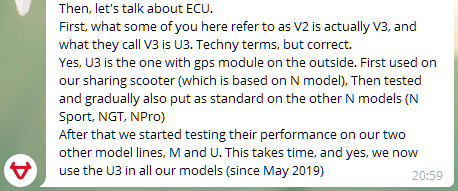

There are actually no Nsport with the U3 ECU. The latest models with U3 ECU are the Nlite and Upro in its latest iteration.

Thank you for the clarification, then "posting Augamarin" may have made a mistake, he thinks he has a N1Sport, it turns out to be a Nlite, do we agree that the firmware TRA01E07 belongs to the ECU u3?
Danke für die Klarstellung, dann hat "posting Augamarin" vielleicht einen Fehler gemacht, er denkt, er hat einen N1Sport, es stellt sich heraus, dass es ein Nlite ist, stimmen wir zu, dass das Firmware TRA01E07 zum ECU u3 gehört?

Interesting, maybe there is a new iteration on its way. My information is NIUs official dealer software chart as of July 2nd and there is actually no update.
Anyway: Until the new ECU will become available as a spare part it will surely take minimum 6 weeks. ATM the new ECU version isn't even on the spare parts list.
