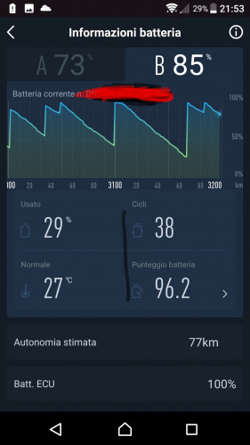

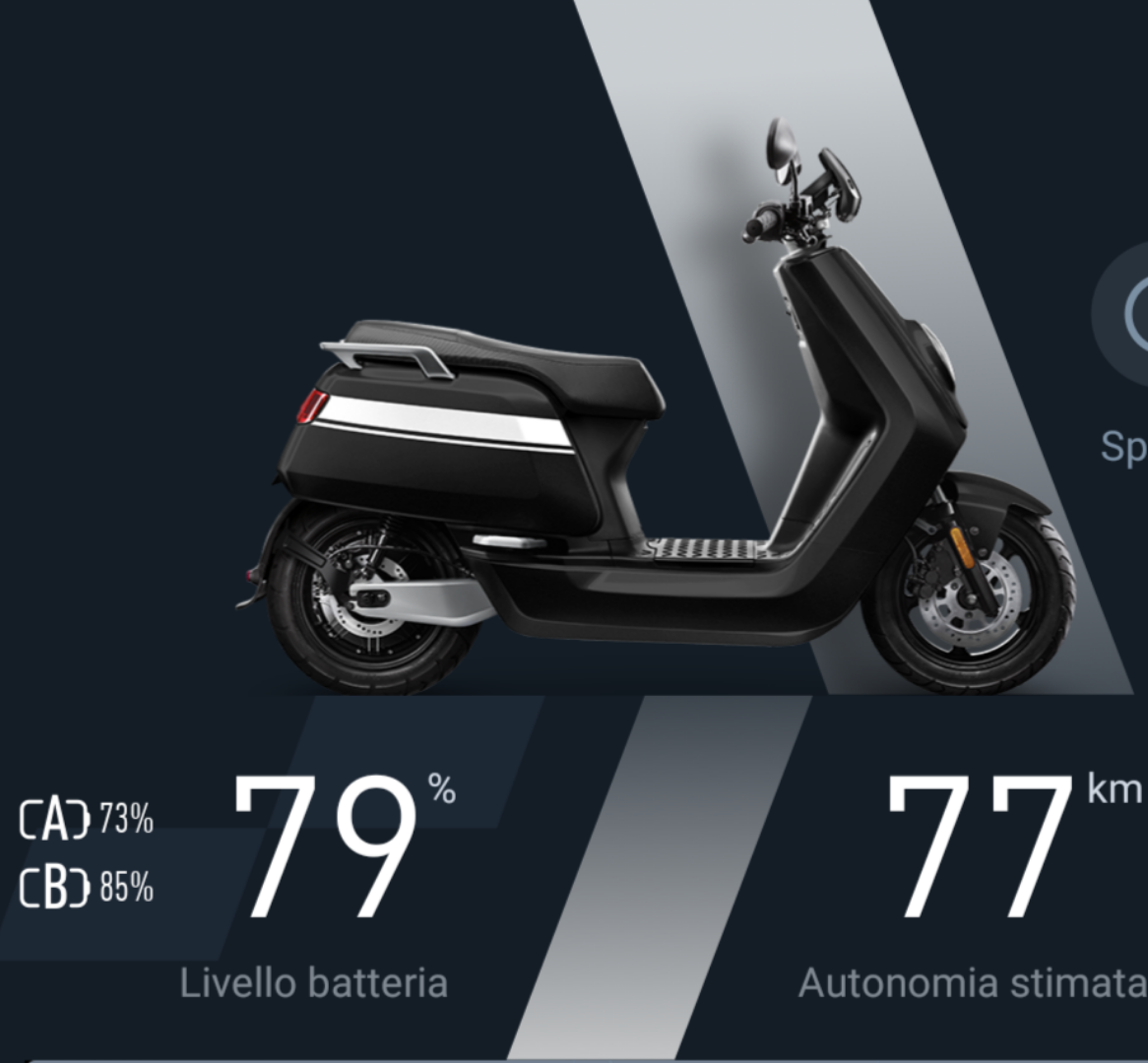

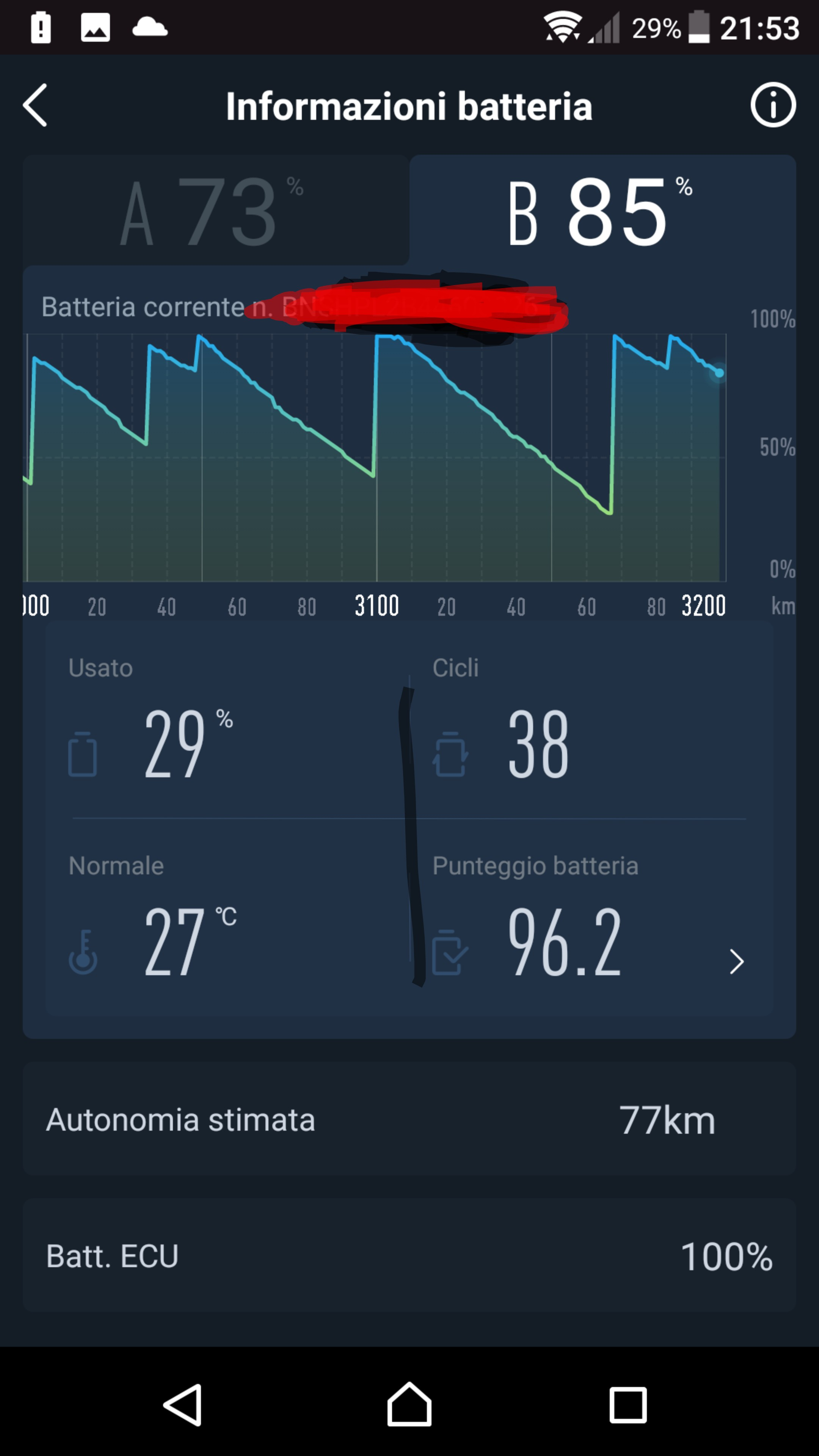

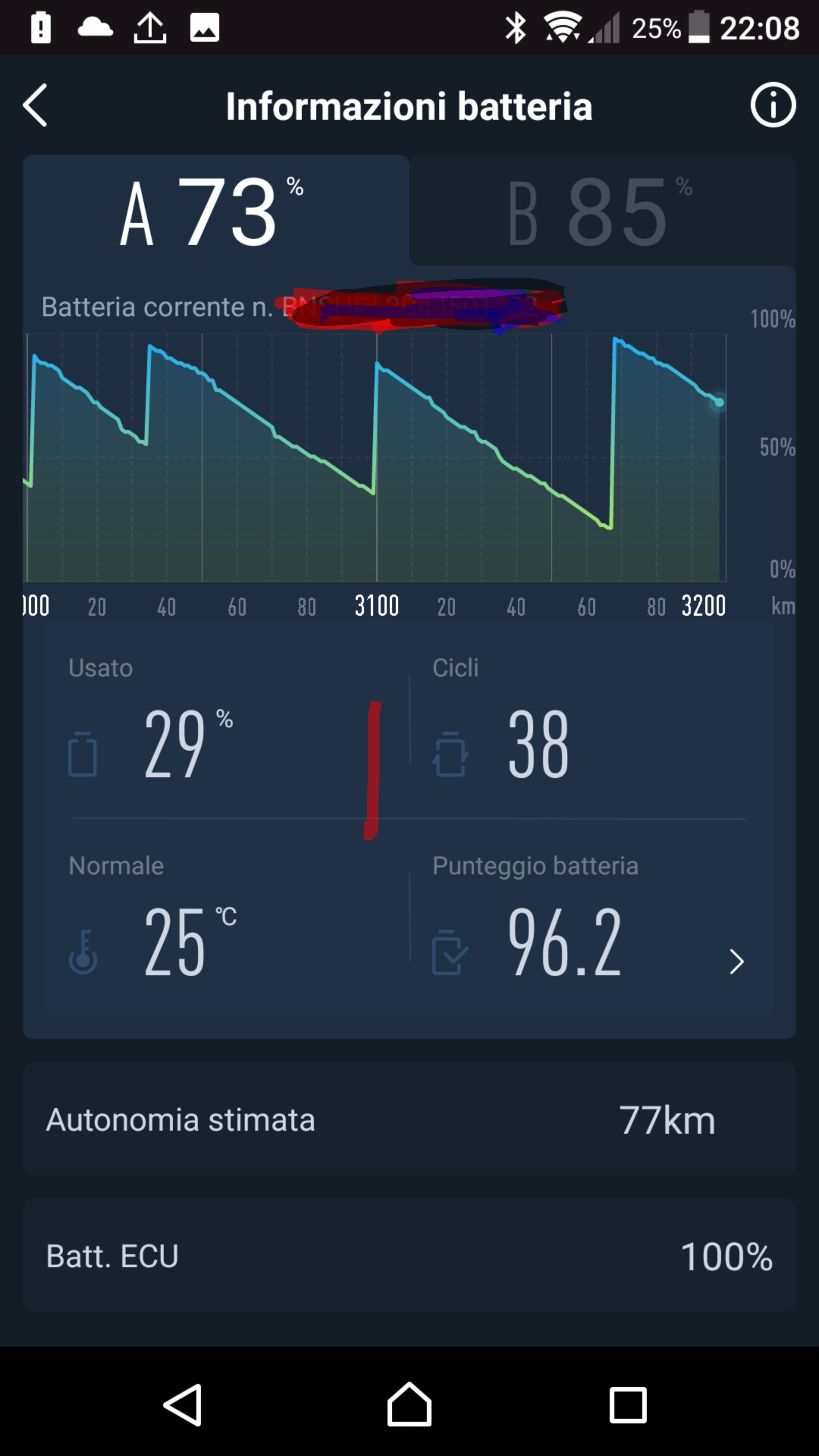

Idem, battery B higher (not correct). This after installation of 3.9.18, before was ok.

Are the values shown in your app the same as shown on your dashboard?
icy q
Beiträge: 12
Registriert: Di 26. Mär 2019, 20:46
Roller: Niu n-gt
PLZ: 36000
Land: anderes Land
Re: NGT Akkus verschiedener Ladestand
Beitrag von icy q »
Yes
