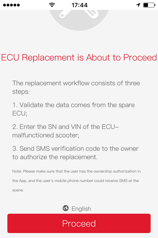

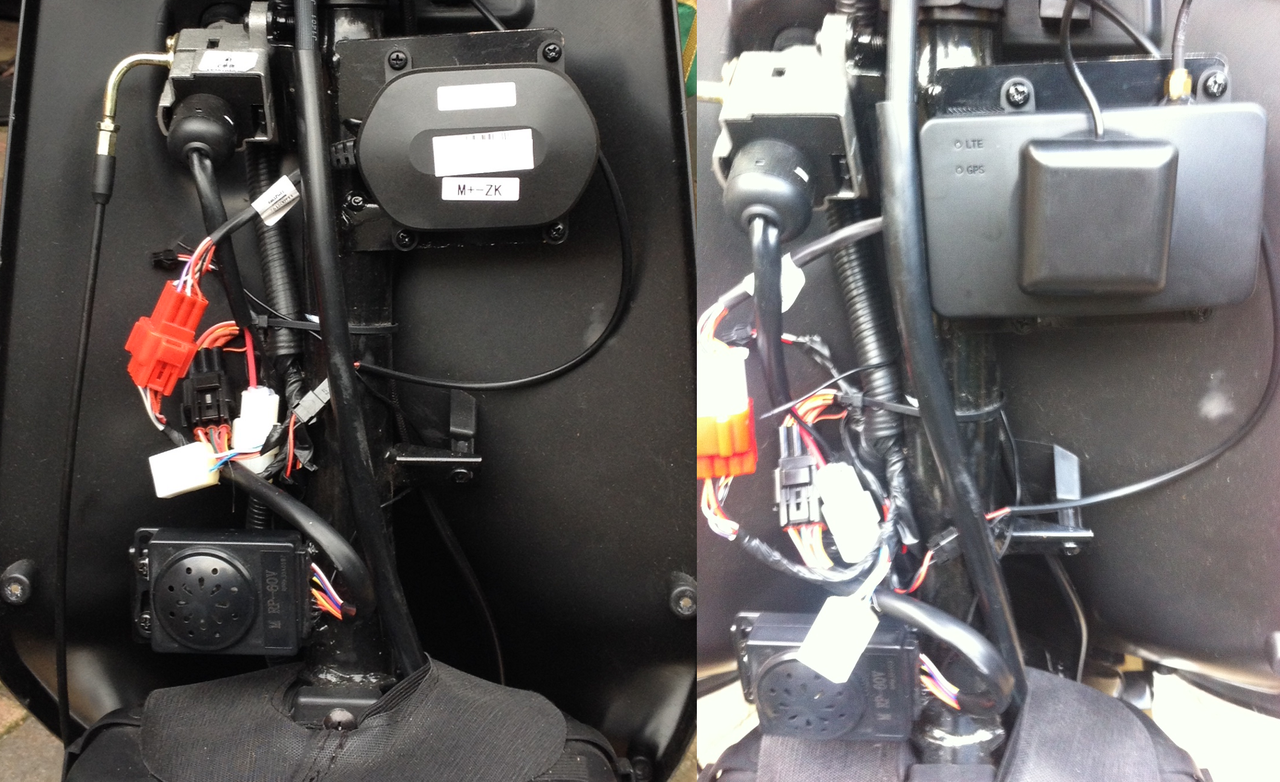

Tuesday my ECU was exchanged for the u3 version.
I looked behind the front cover and indeed, the somewhat angular ECU with the external GPS antenna is mounted.
A sticker with type indication indicates that it is the u3 and the firmware version would be TRA01E07.
Unfortunately I can't confirm this, because the replacement flow consist of several steps.
I am now waiting for a SMS with a verification code to confirm the authorized exchange.
It is not entirely clear to me how to proceed, but since it is still not possible to re-bind the scooter with the new SN in the App, I leave for the time being the old SN binded in the App, because I wouldn't know how else to receive a SMS from Niu. I do not use my cell phone number in the App, without a binded vehicle I will not get into the App.
At the moment it is also not possible to confirm whether there are alarm notifications and what type these are.
Unfortunately, I had to conclude that the alarm does not respond better than before. I had expected that the u3 with the 3-axis gyroscope unauthorized movements would also sound the alarm when the alarm is on, but this does not happen.
