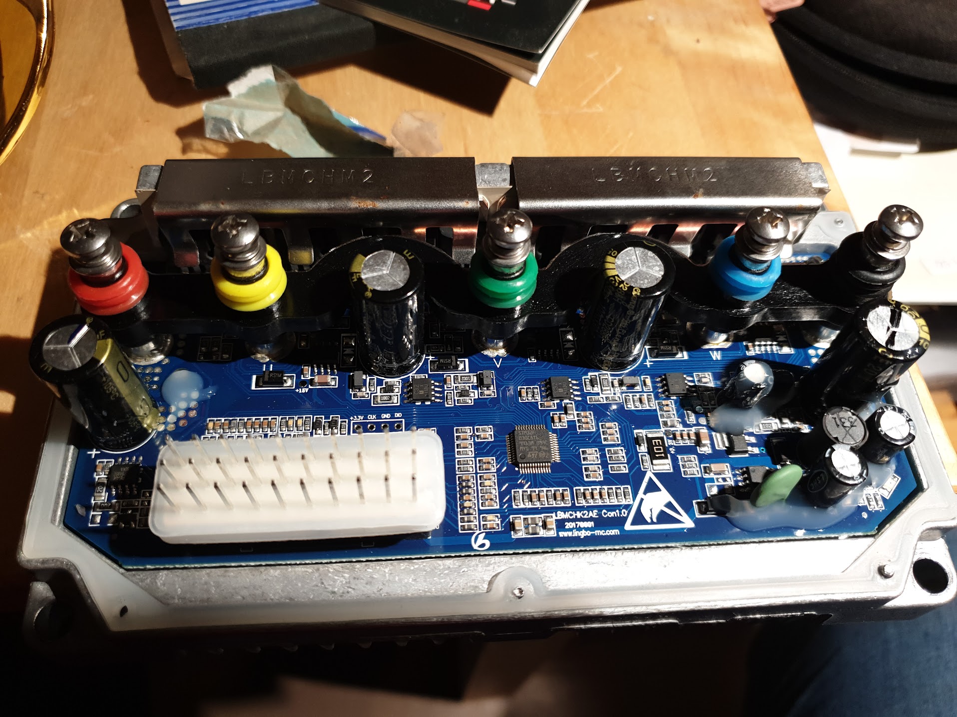

I have an IVA E-GO S5. I haven't gotten anywhere yet, but I found out a couple of things. First, what the controller board looks like (I opened it):
My controller is a ZWK060140A and apparently of type: Lingbo LBMCHK2AE. This seems to be the same controller as in a Super Soco TC as described here:
https://bit.ly/2UwTPq2
Which suggests one could connect to the controller using RS485 on pins 13 and 23. The S5 firmware is probably different from the Super Soco TC, so it's quite likely you can only change the speed setting (25/35/45) that way. If it works at all. But judging from the Super Soco TC forum it seems that the controller does accept firmware updates, so it may be that something will be possible at some point. I have a USB to RS485 adapter lying around somewhere, so I'll probably try to connect to the controller at some point. Will update when I get around to that.

SlashV hat geschrieben:
So 15. Nov 2020, 23:34
