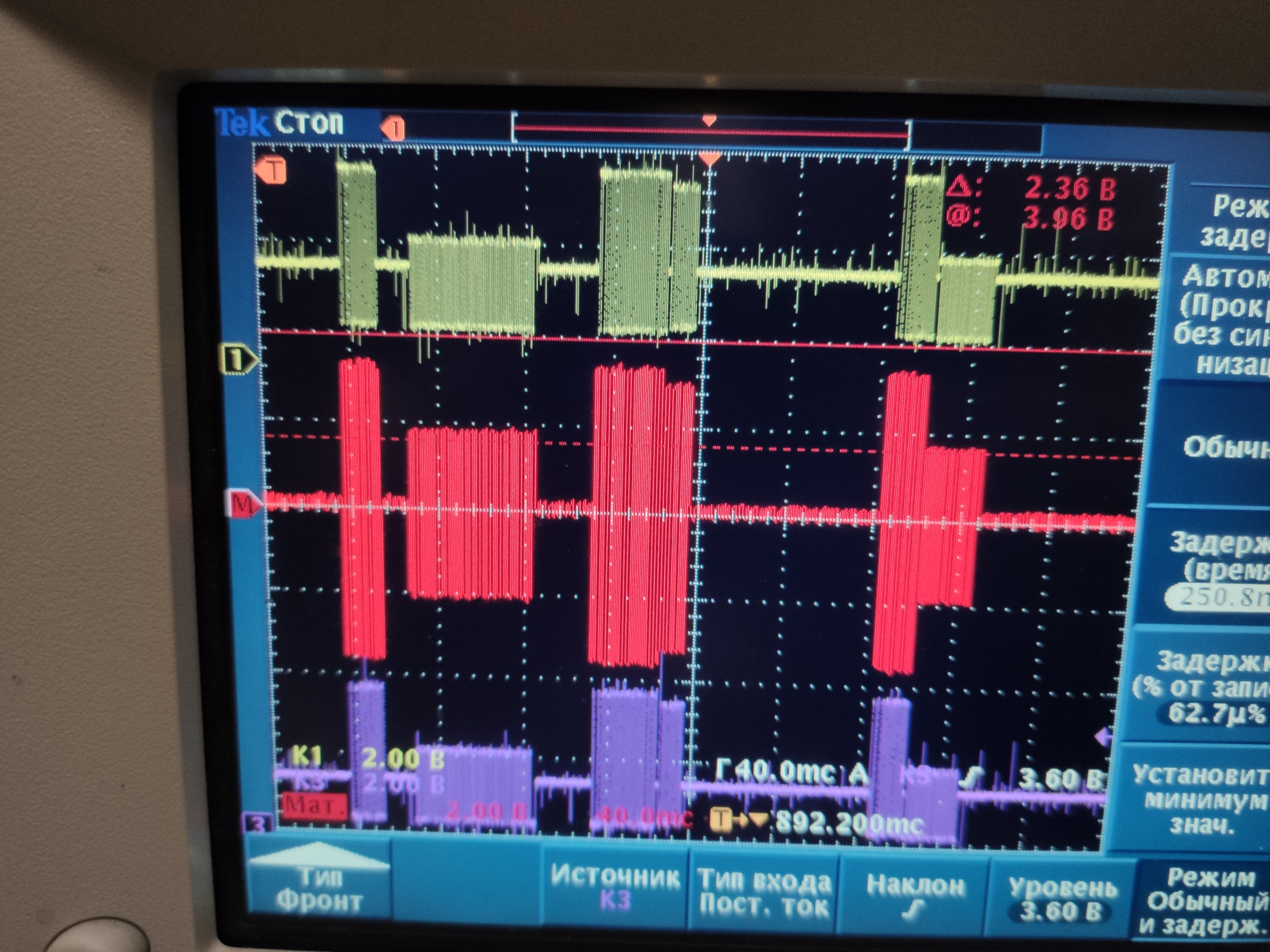

Does it repeating every 56 times?slash_spb2 hat geschrieben: ↑Mi 26. Apr 2023, 01:49protocol with cyphering on RS485 bus. I do some sniffing but data every time different.

ECU send packets every 120ms
By the way
Get connected to controller STM32F030. But there is level 1 protection, so read flash is no so simple...
The only way seems to write Lingbo LBMC HK2A factory firmware to do some tuning with LBMC GUI but with lost compability with NIU RS485 protocol and lost some parameter on dashboard and cloud.
By the way

I have a spare NIU HK2 controller (the older one with two connectors) and a ST-Link to flash the STM32.slash_spb2 hat geschrieben: ↑Mi 26. Apr 2023, 14:38[...]
But where to find the image-file?

The only way is readout firmware from reference controller.
https://github.com/racerxdl/stm32f0-pico-dump
If some one help with that it's will be great)

May be we could start reading out our NIU controller to verify this hack.
I got a pico as a gift, but I will need some time to learn using PlatformIO.
Attaching some wires should be no problem.
I have to check how to start on a Mac.
