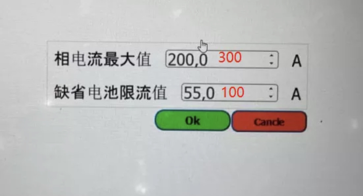

I‘m in contact with my chinese friends, but till now no solution, only to increase peak to 300A und current to 100A …. no change, and I fear to overload the motor
Let’s see what is the next proposal from them
We will not give up !

My Battery BMS only accept 65 A . With 100 Ampere i fly to the moon.

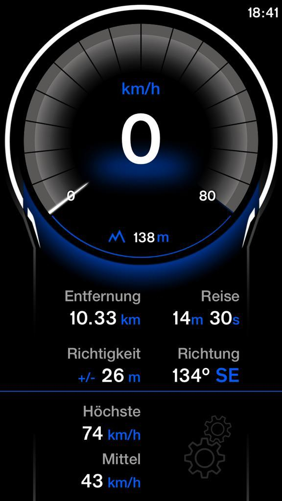

Bisschen gespielt
