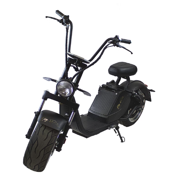

Now I would like to have more power when the bike starts. You know it starts very slow.
My problem is that I use the bike to transport fishing equipment to the beach and many times it does not starts at all. I have to push the bike until it starts.

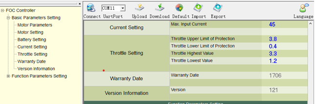

I do not know if it is possible to change these settings on the controller, but if it is I would like to do it. For that I need guidance.
If there is someone how knows how to do it, I will appreciate some help.

The only adjustment what you can do is to increase „DCcurrent“, what is your current value ? 45A? You can go up to 55A.
If you get some issues reduce it step by step 1A

Where is in the controller shell I change the setting?
Is this the right one? “Current Setting” Max input Current: 45.

Yes .. this is the value
Try 55A and Go step by step back, if any issue accure
If there is no issue and you aren‘t satisfied… you can go to 57A … but 10A plus should have a positive effect
