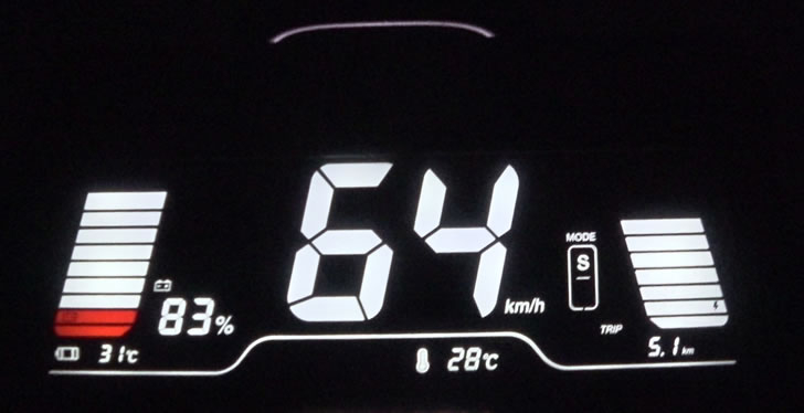

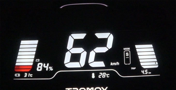

Hey deadropine
I have not been able to login lately, therefore the late response!
I used the parameters from vlad_vy, which I also mentioned in the earlier post, nothing else.
The speed is what the speedometer is showing.
I am currently changing the chain drive to a custom belt drive, and have not decided about the gear ratio, but this could also change the final speed. I am just not sure my speedometer will show the right speed afterwards, as I suspect it looks at the motor revolutions!

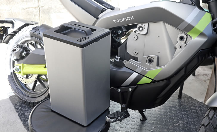

Tromox Mino B - Removal of cowling
https://mihiro.sakura.ne.jp/shimoken/mino-b-004.htm
