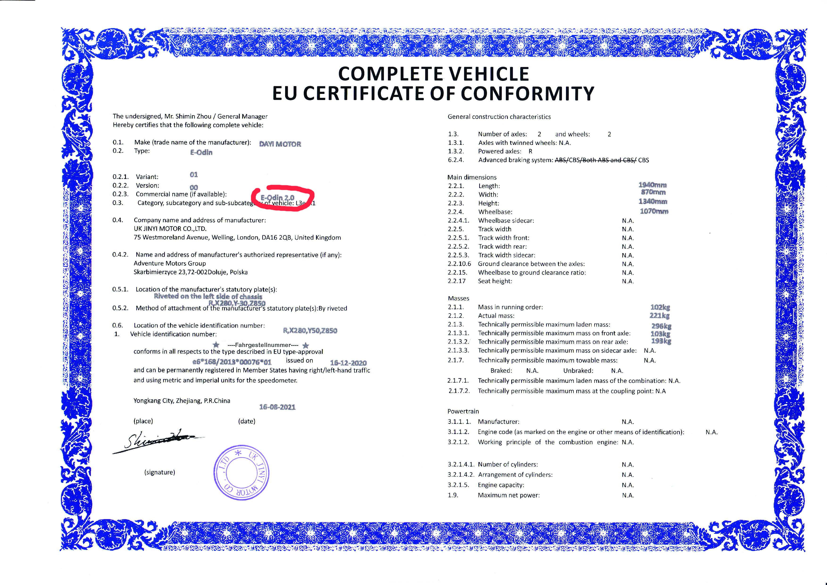

E-Frank hat geschrieben:
Fr 23. Jun 2023, 09:18
....Der Verkäufer ist nun nicht mal mehr sicher, ob es eine Odin 2.0 oder die 1er Version ist...

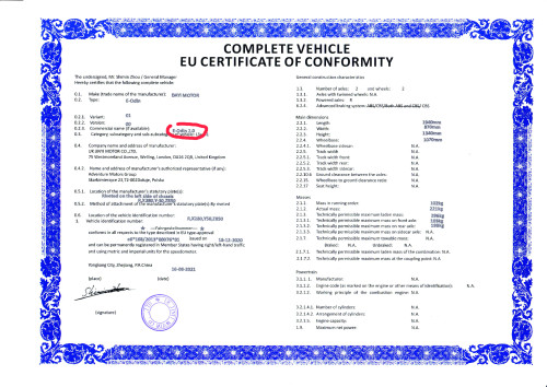

Nun, das sollte sich doch in der COC nachlesen lassen (1. Seite):

jeff-jordan hat geschrieben:
Fr 23. Jun 2023, 09:40
My COC for E-Odin with AMR is a little bit newer + says "E-Odin S".
Odin-COC - kopie.pdf
(305.87 KiB) 87-mal heruntergeladen
Zuletzt geändert von Miguello80 am Sa 24. Jun 2023, 18:16, insgesamt 1-mal geändert.

Miguello80 hat geschrieben:
Sa 24. Jun 2023, 06:11
And looking at the masses, it's a little bit heavier.
I guess that these +5 kg are related to a "build in" charger.
Do you have a type-2 charging socket at your bike?
But it should technical be an E-Odin 2.0 with -most likely- a fardriver controller (even so that you've got an 6kW AMR motor).
Miguello80
Beiträge: 248
Registriert: Do 8. Sep 2022, 03:57
Roller: E-Odin 2.0 6kW AMR
Land: anderes Land
Wohnort: Prague, Czech Republic
Re: Rekuperation (EABS) einstellen
Beitrag von Miguello80 »
Sa 24. Jun 2023, 08:38
AMR motor may be a little bit heavier than QS so this may be that +5 kg difference. Also battery is 120Ah instead of 100Ah.
No, it does not have onboard charger. But I mounted 40A charger onboard recently :)
Do you have a type2 charging socket at your bike?
Nope. After mounting 40A charger onboard I still use cable (type2->schuko).
Yes, it is still "2.0", they changed "only" motor and controller. Controller IS Fardriver (sort of custom made "72120" 120A/400A with cover instead of 72330 150A/330A, rated voltage - 72V120A - is the same)).
