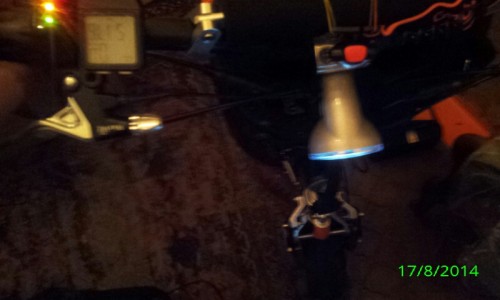

Hello
I discovered your forum yesterday and today I ran out. :shock:
This morning I normally share (fully charged battery and full).
At my first stop (I deliver the newspaper) no way to start, no juice. :evil:
I then put my second full battery and also I have some electricity (the front and rear lights and horn work) but no gas in the handle as if the engine was dead.
The decontrol seeing red green yellow battery lights.
Are you aware of this type of failure?
What can this be?
Thank you very much

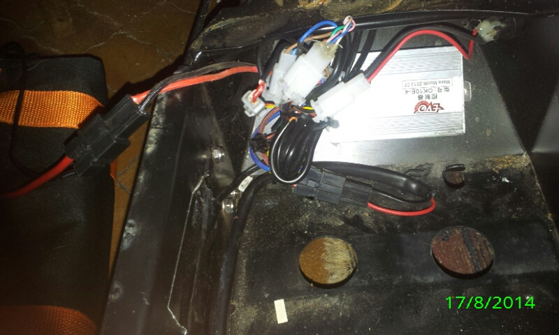

Re: Unbootable but current ok, so what ?
Beitrag von John_F-57 »
the dc-dc-converter is it ?
> everything seems connected
the lights work
> the handle rotates normally
I tried it with a new fuse, it's the same thing.
This battery is almost new.
Is it the engine?
Is the throttle?
In your opinion
Thank you very much ...
Hello there
After testing with a multimeter
- With the battery that was in place during the failure, 3 of 4 batteries died (voltage = 0) and the fuse is blown
- With other battery 4 have the correct voltage (+ - 13), the fuse is ok
I have not yet figured out how to test the "Steuereinheit" but I ordered a new and 4xCSB battery.
