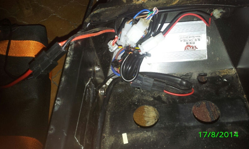

Hello
I discovered your forum yesterday and today I ran out. :shock:
This morning I normally share (fully charged battery and full).
At my first stop (I deliver the newspaper) no way to start, no juice. :evil:
I then put my second full battery and also I have some electricity (the front and rear lights and horn work) but no gas in the handle as if the engine was dead.
The decontrol seeing red green yellow battery lights.
Are you aware of this type of failure?
What can this be?
Thank you very much

John_F-57
Re: Unbootable but current ok, so what ?
Beitrag von John_F-57 »
Hello there
After testing with a multimeter
- With the battery that was in place during the failure, 3 of 4 batteries died (voltage = 0) and the fuse is blown
- With other battery 4 have the correct voltage (+ - 13), the fuse is ok
I have not yet figured out how to test the "Steuereinheit" but I ordered a new and 4xCSB battery.
Good day to you.
