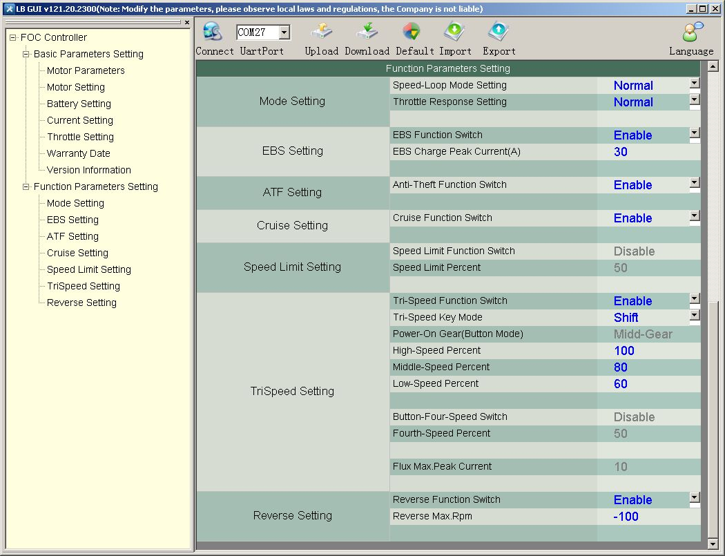

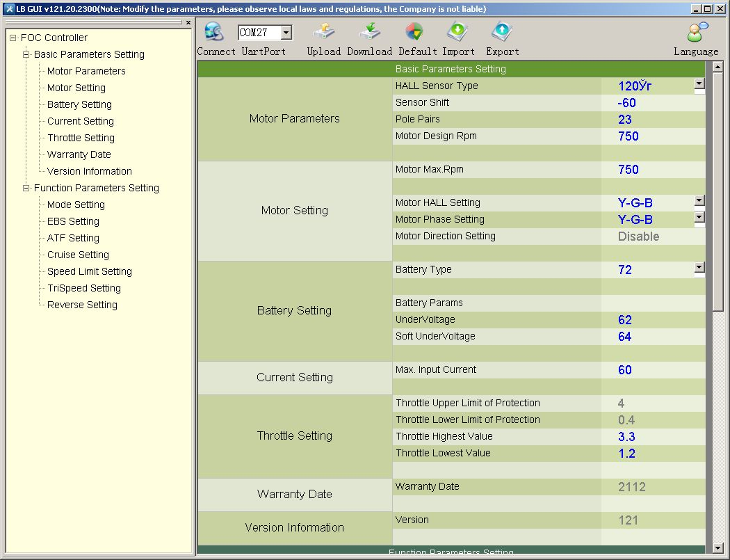

Just for reference, default settings for LBMC072152HK3AP:
So, it looks like the number 2275 (08 E3) with offset 0012h has not relation to speed limit.
LB GUI v121.20.2300 connect to controller with USB-TTL (CH340) adapter or original Lingbo USB cable (CH340).
Decoded FOC file:

@deadropine
Can you send your version LB GUI v121.20.2300? I see that your screenshots in some places different from my screenshots. I can't directly edit some values.
@deadropine

Added small correction to both decoded FOC files. Offset 0104h: (bit 6 = 1, if High-Speed Percent > 100)

FOC file header, offset 001Ch and 001Dh.
001Ch: 7F : (bit 8 = 0, disable Throttle Upper/Lower Limit change) Controller ID
001Ch: 7F : (bit 4 = 0, disable Speed Limit change) Controller ID
001Dh: A0 : (bit 8 = 0, disable Motor Direction Setting change) Controller ID
001Dh: A0 : (bit 6 = 0, Motor BEMF Constant) Controller ID
001Dh: A0 : (bit 6 = 1, Motor Design RPM) Controller ID

Can you change those parameters or will they go back to the default settings when trying to transfer them to the controller. Is this "disable speed limit change" setting something that could help.
