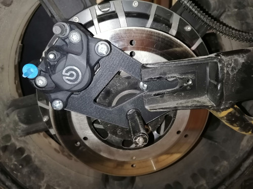

Project "BrOdin" (Odin with Brembo brakes) finished.
All calipers are original. Rear bracket is made with laser, front brackets are factory, needed only a little bit of angle grinder (I will make new ones because of new 300mm brake discs but it will wait now). Works great. I have not try it on road yet so can not compare whether they brake better than original but I am sure they do.
Brake levers are chinese copy of Brembo Racing 19RCS Corsa Corta (65 EUR on Aliexpress, original costs 10x more). Works much better than original levers.
Brake hoses are the same, some bolts are new.
