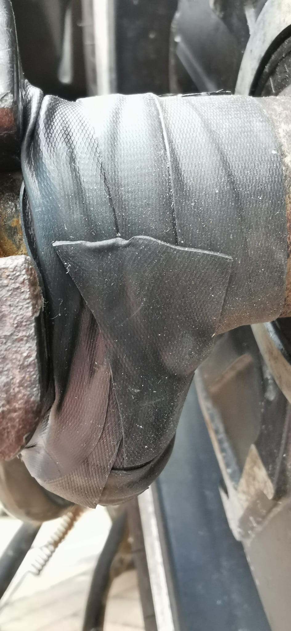

Re: Nützliche Basteleien an und um die E-Odin herum...

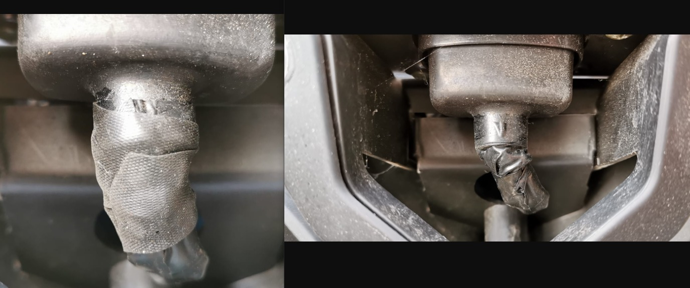

Self amalgamating tape found. Phase wires wrapped better.
Also wrapped the cable to the instrument panel with the self amalgamating tape for better protection.

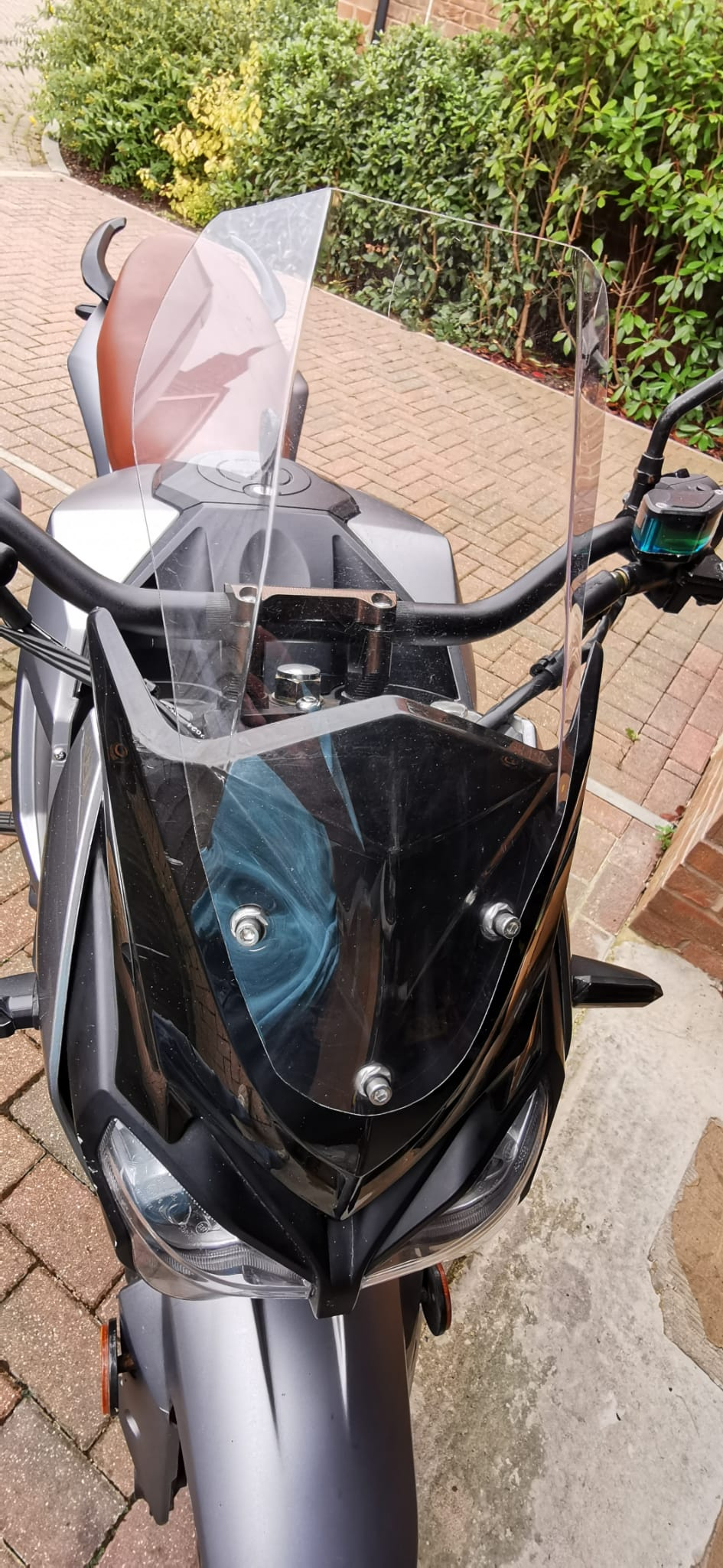

I saw that (back of instrument) when I was trying out a new screen, this is just a prototype using 1mm polycarbonate I cut out for sizing, it will need to be thicker. I am just going to size this up first, see if it works out in riding.

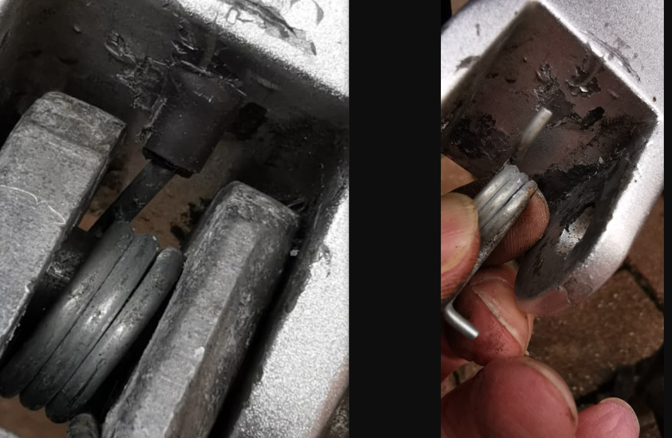

Scratchy-scratchy on the footpeg. Ouch!
I put two layers of heat shrink on the end of the spring, wrapped over each other, but the damage is already done there.

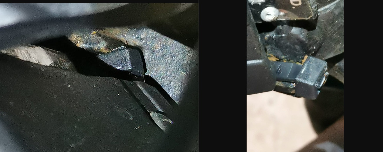

The right hand lock was going over too far and the stop was not engaging before the bars hit the 'tank'.
So I added a large (7.8mm) cable tie to create an extra engagement 'lump'.
It also makes the end lock softer doing this. I tried doing the same on the left, but it kept falling off for some reason, but that side seems OK and does reach the end stop on full lock, though the bars can still scrape the tank a bit.

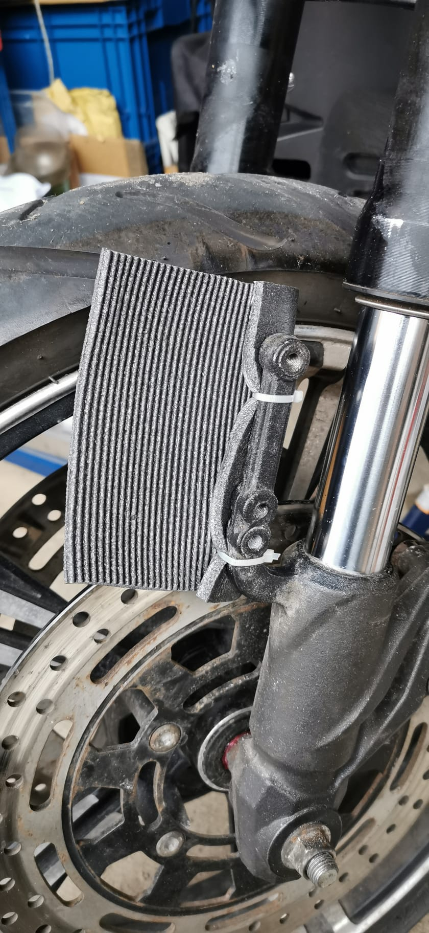

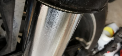

More weather proofing.
The front fender is not good. It leaves mud spraying up, and I notice my stanchions are scratched (from mud being wiped off, I think).
So I added thin foam in this way.
The stanchions now look better protected from spray coming from the front. I will see how this performs.
